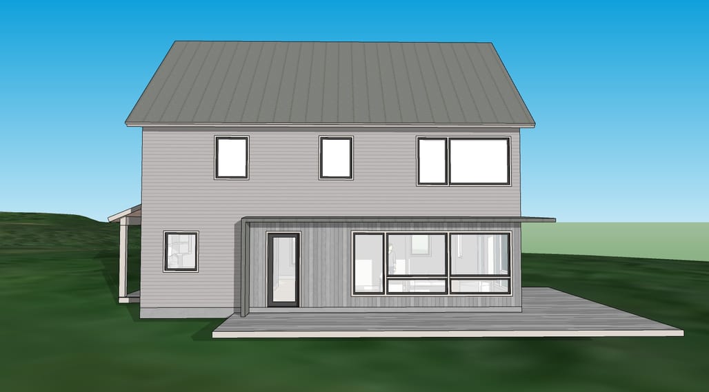

I have a client who is unsure about this brise soleil detail. At least that's what I call it, but I want a solid roof to keep rain off the door. I'd like to wrap all surfaces with the same steel panels that we use on the roof, but open to alternative ideas. I have hidden supports already designed. Does anyone have a photo of a similar detail they could share? I haven't been able to find any online, I don't do photorealistic renderings and this client needs to see for herself--she's not capable of trusting others' opinions. (Not unusual among my clients, unfortunately.)
The goal is to protect the door, provide some window shading and screen a view to the road. The house is a high-performance, Pretty Good House on a fairly tight budget. Thanks for any help.
Is the concern performance or aesthetic? I do not have any images in mind, but am curious.
Aug 27, 21 5:13 pm ·
Aesthetic. She hasn't seen this exact detail in person so she can't decide how she feels about it. I should have mentioned that I'd also take opinions on whether it's a good detail, aesthetically--I like it but I may be too close to it.
Aug 27, 21 5:16 pm ·
I like the idea of it. I question whether the standing seam would work there, the 2" standing seams might look a bit odd.
Most standing seam manufactures are not going to warrantee a product with 1/4" slope (which is probably why you're not finding many examples). You would have to use something higher grade like zinc or copper, and even then, I'm skeptical. Did you have a product in mind?
Good points, I hadn't thought through the details yet. Of course you're right that standing seam isn't appropriate. I've done flat-seam copper and lead-coated copper (when that was still a thing, pre-Freedom Gray) but never tried it with painted steel. Maybe we do an EPDM roof surface and the rest could be painted steel panels. Though I know they'll oilcan. Maybe I should just do a sloped roof on brackets, like I usually do...
Aug 28, 21 9:58 am ·

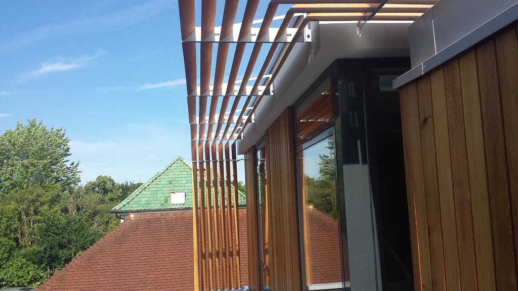

SneakyPete, glass is an option, or acrylic... I had been trying to find photos of one my friend Bob Swinburne designed, finally got it: http://www.mindelandmorse.com/modern-camp.html. In my memory the roof was thin steel but it's a steel frame with clear acrylic panels. The firewood is in a thin steel enclosure, not unlike the Olsen Kundig project below.
Aug 28, 21 10:04 am ·
WG, I'm late to the party... vacation and all that jazz... but like those above, Standing seam looks out of place in that installation. If glass is an option, I'd get a steel shop to manufacture nice brackets and blades and mount a reverse channel (mitered corners, ofcourse) at the end... Glass on offstands for a sloped roof with enough gaps between the panels for draining. my 2 cents. I've had a difficult time detailing standing-seam roofs in small areas.
Yeah Bob's super talented, as are the builders--they have a good, mutually supportive relationship. I see what you mean about the service entrance but I've seen much worse. I prefer to bring power in underground when possible, but it's not always practical. I usually spec conduit and a weather head when I do arial service; I think it looks neater than stapled cable.

I've done similar many times, though probably not as nice as the one you show. In this case it's more about keeping rain off the doors and to some degree the windows, vs. keeping sun off in summer.
I guess I'll be the only one who would like an actual sloped eyebrow before stepping away from the traditional house type towards a modern elevation underneath. Same slope and roofing material as the roof. Make sure the fascia (no matter what you do) doesn't have those obvious weld marks from the previous photo.
Thanks, I have a feeling we'll end up with something like that. I don't like floating pent roofs and the span at the windows is pretty large. Maybe we'll just do another more traditional porch, like the entry side.

Because it's Maine and dark for half the year, and they want the sunlight. And the budget is super tight; we're already about $200K over what they wanted to spend and they can't go higher. But I love the idea; this layout is based on one I designed for myself and my wife, and that we just started talking again about building. Ours will have a grape arbor covered patio on the south, and possibly a greenhouse or high tunnel too.
Low pitch will mean membrane. But think of it like a balcony; over that membrane you can pretty much use whatever as a protection board like zinc plates, wood, etc. on sleepers. Hide the drainage in a fascia entablature or internal drains.
You can do a standing seam at 1/4-inch per foot. Raise the corner, slope parallel to the wall and drain down those wall ends. It’ll be a ship’s prow.
There are various high-build coating systems. They can provide a waterproof surface at low pitch.
Also; sight lines… really, who’s looking at the roof? Would you even see a simple TPO on approach or would it take you standing on the second floor, right at the window to look down?
Re-examine your structural support; If you are going to fabricate brackets, I’d look at steel purlins out to edge then frame between these (less brackets and the cost is in the welding anyway so you can space wider).
Cost is going to be your biggest hurdle. To save the most; lose the brackets and just cantilever some microlams about 8’o.c. and infill between. Less penetrations through the shell but no expensive fabrication. Use TPO membrane, spill to edge, and spend some money on the fascia & soffit that people will see.
The house will sit on the edge of a large field. Nobody will ever see the top of the roof from outside, only from the second floor. EPDM is more common here than TPO but I use it regularly and it would work fine. I've occasionally done flat-seam copper for high-end work but this is on a tight budget. (Tight being $600K.)
For the brackets, I have a few good local fabricators but it costs extra for them to go to the site. So something shop-fabricated and carpenter-installed works best. It's a high-performance home so I can't have big thermal bridges, and the interior is exposed beams so I can't hide framing.
I definitely accept your point about prioritizing the fascia and soffit.

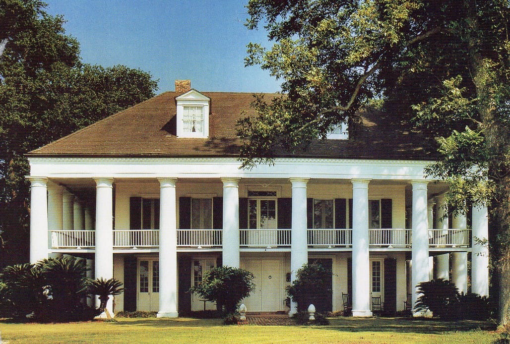

Go big or go home
Gone with the Wind would be uninhabitable in Maine.
