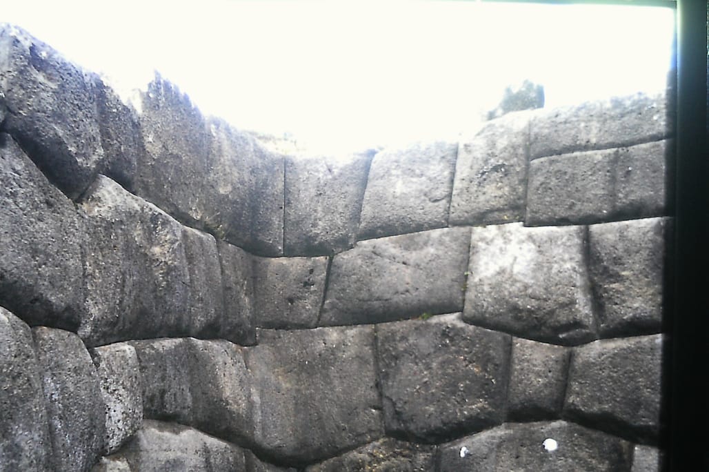

I took these 30 years ago, a door to "huayna picchu", a wall in sacsayhuaman and all of macchu picchu from the top of the huayna. There is more texture to the materials everywhere, look for it.
Dec 3, 18 12:16 pm  ·
