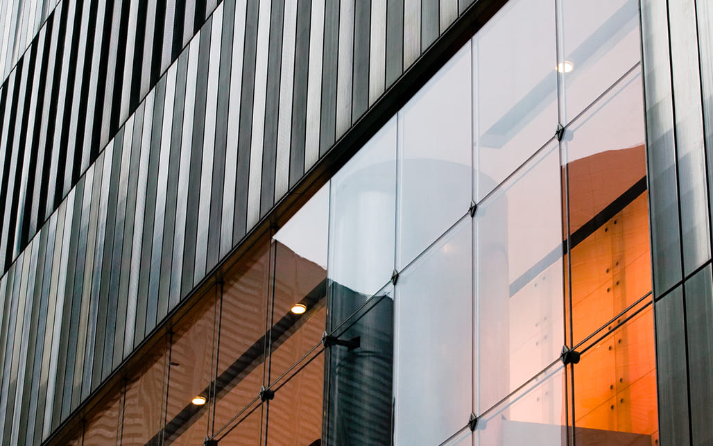

Anyone have experience with them?  I've done some research and understand their structural behavior, but am concerned about the performance of the enclosure.  Most of the images I've come across seem to show just 1 light so I imagine the thermal properties aren't very good.  Has anyone encountered problems with leakage?  Seals failing when the facade flexes?
Full disclosure, this is for a school design project not professional work.
