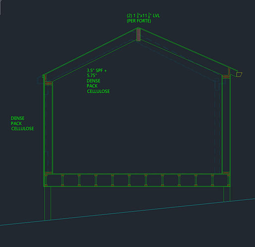

Yes, it's the left side of this section-in-progress:
Oct 15, 24 1:00 pm
The image didn't post. I'll post it as a comment below.

Platform framing answers my question. Any way to have the required FRR on the exterior of wall passing in front of the floor assemblies? Give it it's own structure and you don't have to worry about the floors.
I would extend the exterior wall system (5/8" type X plus 1/2" OSB) down over the floor framing. The interior side of the exterior wall is required to have a rating as well, but a fire would not start within the floor assembly so it seems like that might work.
I added a drawing below.
Or do you mean extend the wall system down to grade? That's possible but causes other problems.

I may not be understanding this correctly as I'm coming from a commercial background.
Is the ceiling / floor in question supporting the rated exterior wall?
What is the type of construction? Or are just just trying to find anything except concrete?
SFR. Wood-framed on wood posts on helical metal piles or possibly concrete piers.
