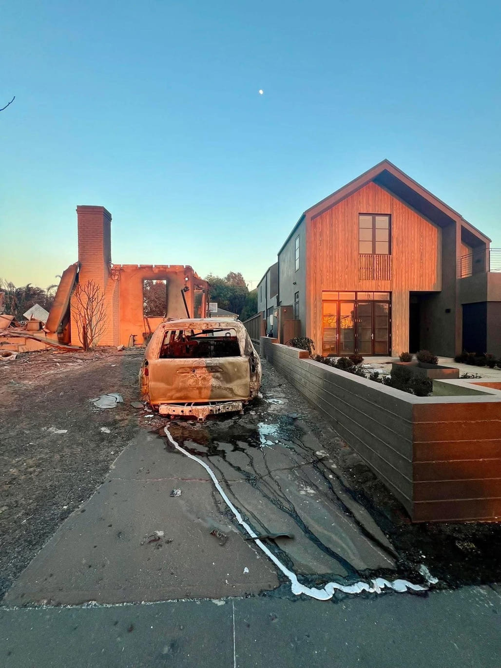

This came up on Facebook and there are questions whether it's real or Photoshop. Thoughts?
ARTquitectos
A home in Los Angeles miraculously survived a devastating fire that ripped through the neighborhood thanks to its design and construction under the Passive House standard. This approach incorporates several fire protection features, such as: - Simple structure to reduce the accumulation of sparks and embers - Reinforced windows with triple glazing to withstand high temperatures - Flammable materials that slow the spread of fire - Ceilings and structures sealed to prevent embers and smoke from entering - Controlled ventilation to maintain indoor air quality Thanks to these features, the home proved to be fire-resistant, while other homes in the area were destroyed.
Not surprised at all. We know how to prevent houses from catching fire due to airborne embers. Home owners are probably unaware or don't take it seriously.
lack of a ventilated attic, no eaves, landscape and material choices are what I am reading about in the similarly survived buildings that aren't passivhaus. The photos showing communities after the fire passed through are devastating and unreal.
Curious - what cause/effect do the ventilated attics and eaves have for higher chance of burning?

Bench - others can likely answer better than I can, but there is the possibility of burning embers getting sucked up into the overhang/ roof and ignite something in the attic. If you are all sealed off, you don't have that concern but maybe others. I've heard that there are ventilation strips for soffits that close when a certain temperature (or ?) is reached, so in theory the embers don't make it inside. I'm not sure I buy that but I also haven't used them.
A builder friend in SLO posted a news video about it as well so along with your help I'm confident that it's legit. I'm sure the Passive House aspect helped a bit, but to give PH full credit is silly--there are many non-PH things that are also responsible for keeping it from burning.
TBH I dont think anyone is wondering why wooden buildings are burning, in the sense that they are pondering why fire exists.
They may wonder why building codes don't protect wood structures and if there is truly no way to have the cake and eat it too.

Real or fake?
ARTquitectos
Passive House plants too?
It's real - Mike Eliason was interviewed for a few articles about it today.

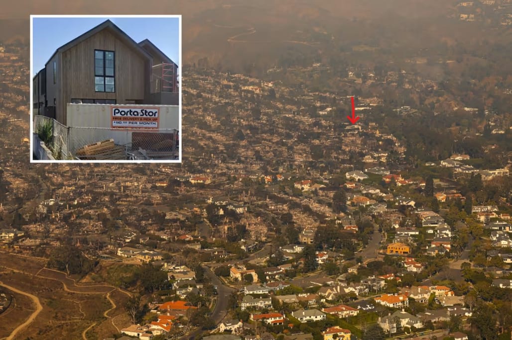

Seems legit (maybe not the passive house claims) - this link has news footage of the house:
How Passive House Design Could Protect Homes Amid Devastating Fires - Mansion Global

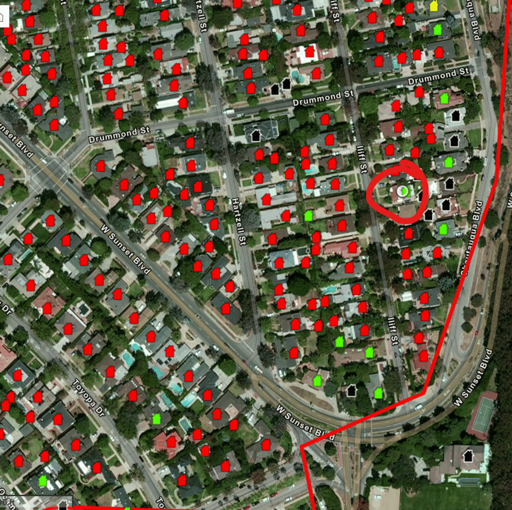

750 Iliff St
Web link context photo with the house located (I think?):
Ah, it's on the edge of the fully-destroyed zone; that explains the trees in the background.
All the chimneys are intact, we should go back to building houses out of load bearing masonry.
This is completely unnecessary.
I saw this house on a news report yesterday morning, the reporter was walking down the devastated street and that one house stood. It’s legit.
Looks like the metal roof saved it.

My money is on lack of overhangs against prop line + landscaping choices.
I don't think they'll make tougher rules... if anything they'll relax them to get things rebuilt faster.

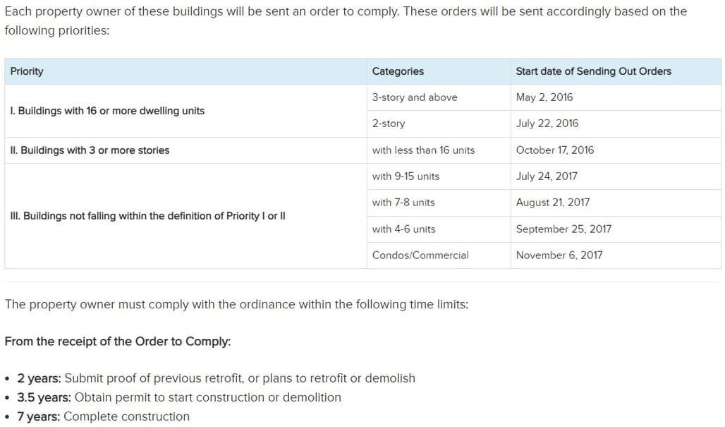

But what was the most recent seismic retrofitting effort? Was that not soft story resi buildings? Granted maybe not SFH but some were pretty small multi-unit buildings.
This program:
Mandatory Retrofit Programs | LADBS
The City of Los Angeles recently passed Ordinance 183893, which requires the retrofit of pre-1978 wood-frame soft-story buildings and non-ductile concrete buildings. The goal of the mandatory retrofit programs, under the ordinance, is to reduce these structural deficiencies and improve the performance of these buildings during earthquakes. Without proper strengthening, these vulnerable buildings may be subjected to structural failure during and/or after an earthquake
