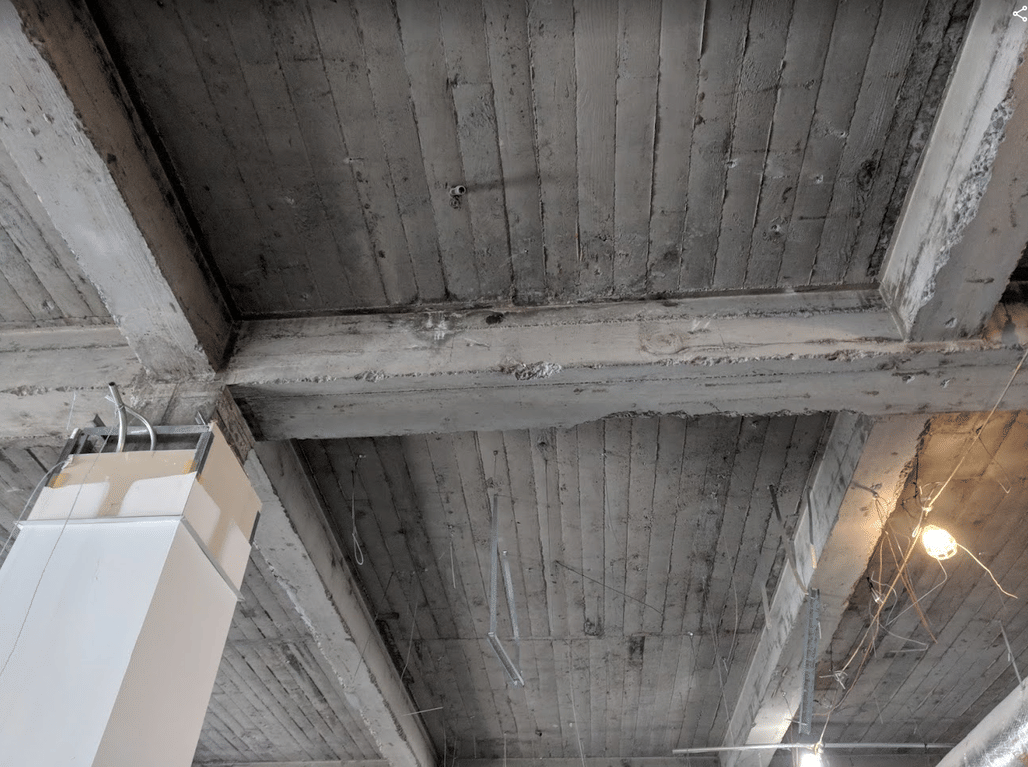

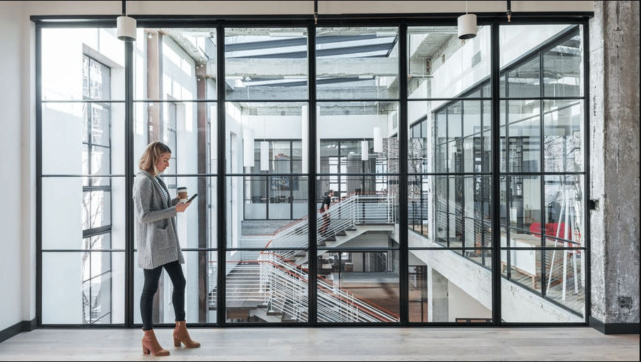

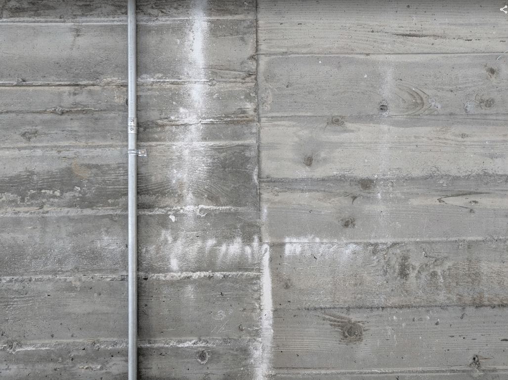

Incidentally this is the same building I posted in the other Post Your Work thread. The project was a renovation of a late 40s office building. Existing conditions were drop grid ceiling and gyp walls everywhere. Pretty dark and soulless. We started pulling the walls back & realized the *entire building* was framed with board formed concrete. Just beautiful textures on every slab, wall, and column.
We left about 75% of it exposed in the finished project. Pretty much everywhere except the exterior walls that we needed to insulate. Sometimes good design is knowing what not to do.
dude... you need to give a warning before you post something like that 2nd pic... some of are at work and don't have spare pants.
Sploosh. Nicely done.
Nicely done indeed. I love finding those types of things on renovation projects that can ultimately change the design strategy for the better.
That said, having worked for a while in an exposed concrete ceiling building, I hope you put some acoustic panels, baffles, clouds, or insulation of some type up there. Even a little can go a long way if it is placed in strategic locations.
WHAT DID YOU SAY??
I just did the core & shell reno, but yeah the tenant put in some acoustic measures.

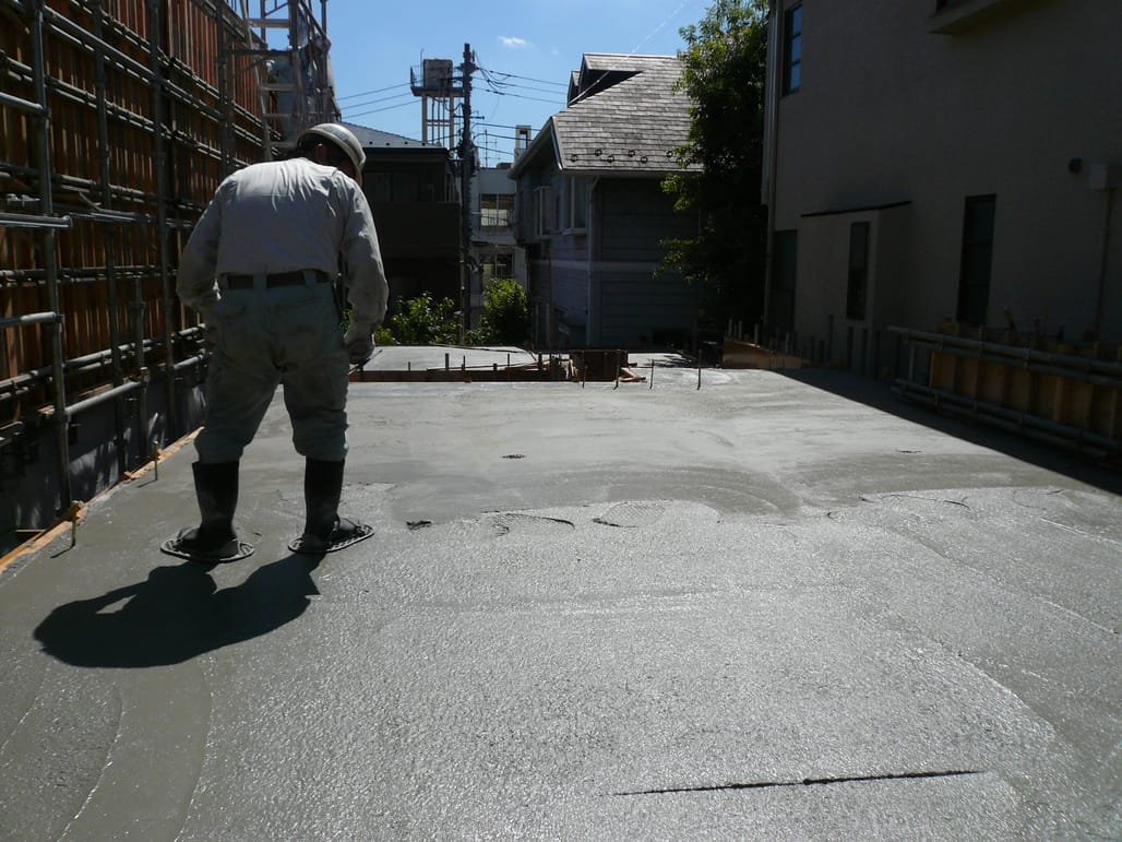

Our first project as an office in tokyo, 12 years ago. The ground floor is concrete and the 2nd floor is wood with steel reinforcement here and there. The beam that supports the cantilever on the right side is reversed and built into a thickened wall that works as a shelf above the height of the beam. It was pretty cool to watch this go up and the concrete came out nicely. My partner and I made the concrete tiles ourselves to save a bit of money for the client. He hated it, I loved doing it.
Awesome project, love the tiles!
Awesome tiles! The whole project is lovely too. Especially like the house # on the end of the beam.
Now that I think of it, have seen this published and rightfully so...
yeah it did the rounds, right at that period when internet was rising and print was floundering. That was when we learned publication didnt really mean as much as we thought it might, although it was very cool, especially for a first project. We also learned that our first clients were amazing and open-minded outliers.
