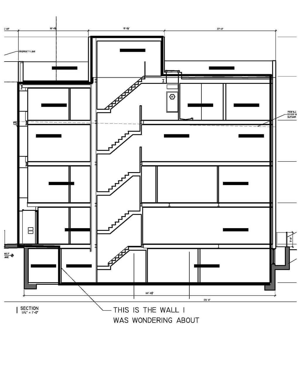

Are there any COMcheck experts out there?! I have a mechanical room in the cellar of a townhouse that will require a combustion air grille so I believe that the room should be designed to be outside the thermal envelope...but I'm unsure of how to categorize the sheetrock wall that divides the mech rm from the rest of the cellar...would that be a "basement wall" or an "exterior wall"?
From you drawing section and in my mind its an interior / or basement wall. Im not seeing how you can ignore the truth that it’s clearly not an exterior wall and if it is an exterior wall, is it assembled as an exterior wall? in my mind its like a unheated attached garage and the louvre is like a window

do you have a plan or section of the area?
Exterior wall.
That's not a section of the OP's project.
If I understand the situation correctly (I'm not sure that I do) it should be an exterior wall, basement walls are below grade.
Yup.
Thanks guys. I heard from another source it was an exterior wall, too...see attached
