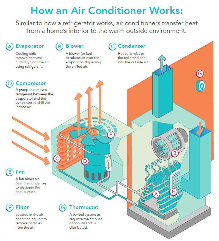

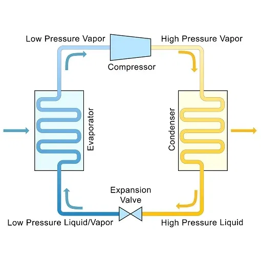

You'll need something to cool the air, leading to the moisture in the air to condense. Then you'll need something to heat the air back up to a temperature that is comfortable for your building.
In a hot climate the second part shouldn't be an issue, just mix the cold air with the warmer existing air. It's getting the existing hot, humid air to cool down that is the problem.
The plus side is when you do figure it out, you'll also have a source of water.
Oct 7, 16 3:40 pm  ·

This is the closest answer here. Along these lines, I wonder if you could design a passive dehumidifier. I'm thinking something like a large air intake that directs incoming air down into a cold well in the ground where moisture condenses then a large tower where it can be heated and mixed with internal air before it enters the conditioned space.
Jul 27, 21 5:13 pm  ·
JonathanLivingston
Maybe just a cold copper coil that circulates water into the ground, provides a condensing surfa ce for air coming into space.
Jul 27, 21 5:14 pm  ·
I suppose something along those lines would work, though the ones I've seen usually involve electricity to run a compressor and fans to push/pull air across the coils.
Jul 27, 21 6:21 pm  ·
