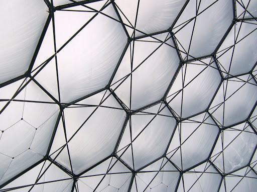

anyway, how about this
link
eden project. etfe can be patterned as well for light modulation -- big spans
